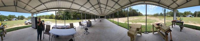

Made a trip out to Saorsa Acres this morning.
Forgot to bring our homemade bipods (previous pic). Had one folding leg bipod and Jake loaned me another. He also set up his LabRadar for us to collect data.
Zoom Zoom, 88's @ 3000fps :)
He had already set up a target stand @ 300yds (called a couple days ago) when we arrived.
We wanted to fine tune a load for the wife's 22Nosgar and my 22Nosler with SB6.5 and 88ELD and 85.5 Bergers. Felt we were close but wanted to compare the two bullets.
I had hoped my super zoom camera would be able to see holes in splatter targets but the mirage just swamped out the images, especially as it got close to noon.
We ended up making a FEW trips down range to check targets.
Using the LabRadar instead of my MagnetoSpeed was nice. Thanks Jake :)
Camera was able to pick up hits on the 300yd steel.
Here's a panorama of all the other shooters at the range today :)
Next trip will be earlier in the AM before the mirage kicks up.
