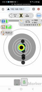

Made a quick practice session Wednesday for a Saturday 600 match.
Most mostly my regular load (old barrel) but took a few with about a grain range in powder (SB6.5).
85.5 Bergers, CCI primers, SB6.5 from 31.55 to 32.55 grains.
Velocities reported by the Shot-Marker @ 600yds ranged from 1827fps to 1996fps.
Lowest load hit low and highest load hit high. Pretty good grouping in the middle loads.
Elevation sort of followed load with a few exceptions. Will have to try again after the match Saturday.
NO WIND for about a hour or so. I'm not that good with wind.
Somehow I think this is a calibration/sensor problem with the ShotMarker this trip.

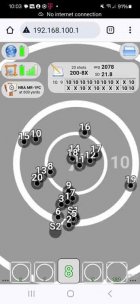

Made another 600yd Midrange match at the Bogalusa range.
Flo and her Savage 22N bolt gun have been whupping my butt.
Last month (600yd) she shot 192-2X, 196-7X, 197-9X, for a 585-18X, 97.5%
Today she shot 196-8, 196-6, and her first ever 200-8, 98.67%.
Had her stop in the 3rd relay and look at her group of 2 sighters and 6 record shots.
She adjusted up 2 clicks (1/4MOA) took a few shots and adjusted up 2 more.
