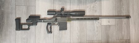

The second build will be in this chassis. Im liking it better in here with the EC Tuner brake on the end. Sporting a 16x42 SWFA. it will be awhile till i get to take them both out as the weather isnt going to be great this weekend. Merry Christmas you filthy animals!
Looks like a "Beast" what are you, gonna Feed it ?

That's, a Sweet Pair to, Draw to !
Mine looks like, the Bottom One, only,.. Blonde and Braked.
