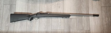

Build number 2 had begun, bought this one for $300 mid 2000's date code. I might be on the naughty list for this one. Barrel will be here on Monday plus other goodies, thanks to @urbanrifleman

Received my second set of goodies today, will have to do some inletting of my stock to get this barrel to free float.
