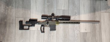

Here she is! Newer production R700 short action 26" 1:8 twist Urbanrifleman barrel. Indian Creek Design chassis 10x42 SWFA Scope. Weighs roughly 14lbs. Loading ammo as we speak. 112gr Barnes match burners with H4350
Make sure to give a range report too please. I have 2 - 6XC’s right now and am always looking for different loads. Rifle Looks Good Too..

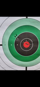

Loaded 10 rounds to 36.5 gr H4350 to sight in the scope. 15 mph winds at my back and this is the result of the last five rounds. Loving the lower recoil, with work up in powder charge and try five more at 100 yards
