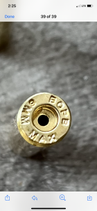

The primer pocket looks messed up in your last picture. Like extra brass where it shouldn’t be. Opposite the 6mm headstamp.
