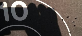

Well did a test at 600, all groups were under 1/2 moa but one group will deserve a try at 1000 yards. It was 32.5 grains of RL17 with the Berger 90VLD. I will probably not try the load till Monday, unless weather changes those plans.

Did another test of the RL17 at 600 yards today. The All Guard team member was watching the trace. He said it would rise to the top of the 7 ring at it's highest point. That was all of the elevation in the arc of flight for the bullet.
Below is the group.

I counted 8 on the pic...very nice ones. Wondering what I would try next....maybe play with the seating depth a little more. What are your thoughts to try next?
I was using older brass that had been shot in another rifle. Been using this brass for testing. Have the bullet ten in and check neck tension. I am running around 2 thou tension, I am sure that it is soft seating to where it wants to be. This is my usual routine. Most times just a thou of tension, but never more than 2.
Are you turning the necks? I do, and size the wit a 246 bushing and the run the necks over a K&M expander.
