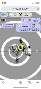

I chambered one up for my PRS gun and love it. Shoots as well as a 6BR with less recoil. I shot it one relay at a 300yd F-Class match and it shot a 200-14x with 25¢ 88gn ELDMs. With a little tuning and better bullets it would be really tough. E8E5CA93-3ADA-4E05-9BBD-95CBEA03FC84.png
