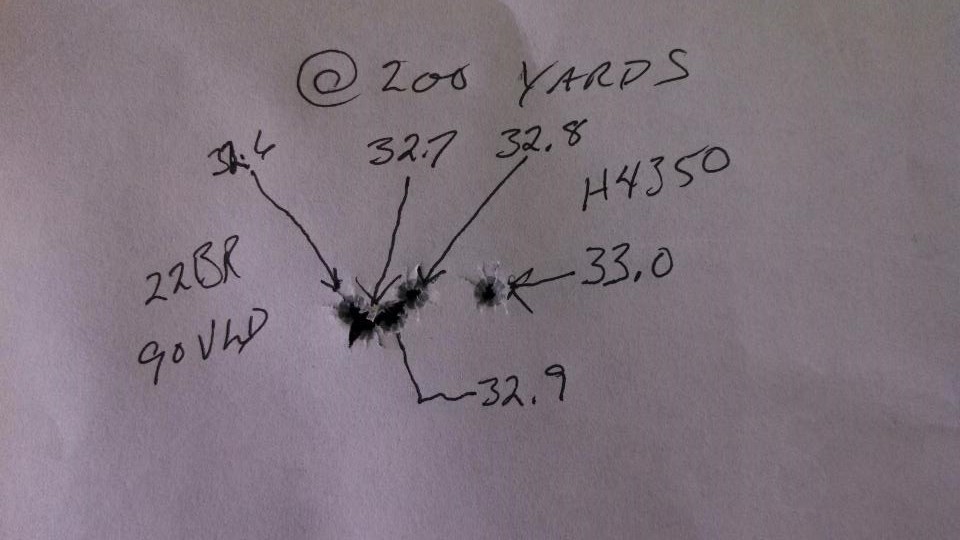

Randy asked me to post this one. Load work today
What I find interesting in that is something I've seen in my 308s, as MV goes up the POI moves right.
