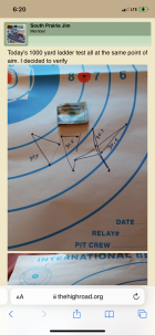

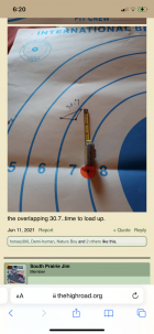

While tuning at distance..I took a chance on a slightly hotter load at the nationals that I thought might shoot small enough to place .. or break out
