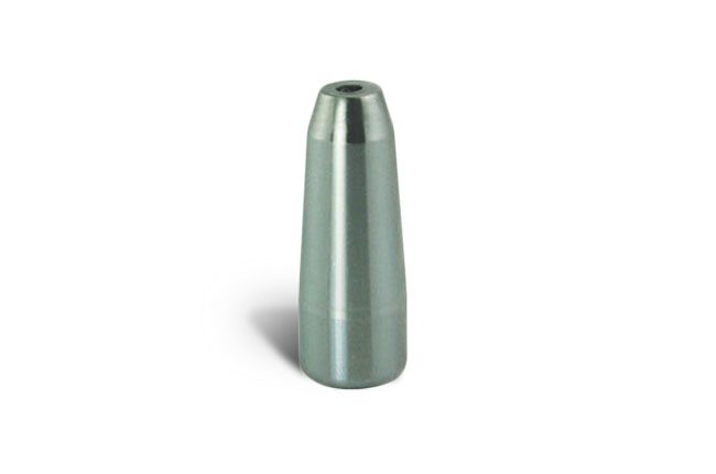

So, I heard more from 21st Century. Their turning arbors are 2 thou under nominal ie .241" for 6mm and their expander mandrels are 1 thou under nominal (0.242" for 6mm). I could try with these (and additional bushings) although it's a bit of a hassle to dismantle the neck turning lathe to get to the turning arbor. I might just order a couple more bushings and a couple of their mandrels. Their caliber specific mandrels have a tolerance of + / - .0002 (Quite useful for practicing correct caliper usage as well.)
My Berger 6mm 105 Hybrid Target would appear to be 0.2425"
21st Century mandrels are Nitrided, does anyone make them in Carbide?
I've had mine made from carbide locally at a carbide cutter grind shop, but it was a personal favor. It would be nice to be able to order them from someone who makes them in production and in tight dimensional increments.
I had two different companies make them for me over the years, but one company had a real old school purist who has since retired. His were dead nuts on size in 0.0002" increments. The second guy wasn't so talented and are not as precise.
I can't help but find it partly ironic that over-reducing with a bushing and then expanding with a mandrel is what should be achieved with a (better) expander ball in the resizing die. Maybe dies should have a selection of (redesigned) precision ground expander 'balls' or 'pins'.
So Whidden Gunworks - I have their sizing dies - offer "expander balls" in one thou increments. https://www.whiddengunworks.com/product/expander-balls/
Sure they're not in 0.5 thou increments and they're not coated but surely doing contraction and expansion in one go would make a lot of sense. Thoughts?

But the bushing needs to account for brass thickness. Given I have the 21st Century neck turning lathe I already have an expander mandrel of 0.241". So, presumably, as a starting point I should try a bushing of .239 + 2*0.013 = .265"

Given the amount of working of the brass neck, are you guys lubing the necks ahead of sizing (as opposed to just the case body)? I presume you lightly lube the expander mandrel. Preferred lubricants?
EDIT: 21st Century says their lathe expander mandrel is "about 0.242".
I dip the case neck in powdered graphite to lube it. Matt
