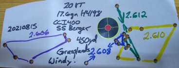

Quick little update: the 20 Vartarg is still shooting excellent with no noticeable erosion in the barrel. The numbers in this picture are seating depths. The blue, 2.608" seating depth (comparator installed, but not zeroed), would have been a stunning 0.75" group at 450yards had I not jumped the flag and broke the shot with the wind blowing too hard. Still pretty respectable ~2" groups at 450 yards!
Nice shooting! Let's say that blue group is 3/4". Bergers :)
