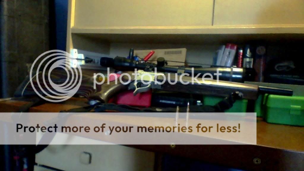

Here is a 20VT with about 3000rds on it.
Adam
