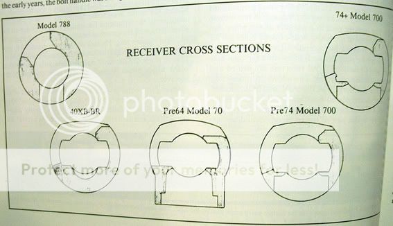

I love my M700 as well so I thought maybe these would help in this thread as well. You can see they have made some changes over time, but they are simple and have the rings of steel to help protect you. That all said, the Savage has also made some head way and changes and they are the second best choice now IMO for a factory rifle, cheapest, and pretty darn accurate as well and they did listen to us shooters when they were asking about stock designs for the new FTR and FOpen rifles they now make. I saw a 6.5x284 in a Savage the other day at a gun store and figured this would make a very good starting entry level rifle for anyone wanting to start FClass shooting. BTW, my main FOpen is a Stolle Kodiak in a Robertson/Speedy in 284 Win but my MR rifle is a sleeved M700 in 6BR and I would have made that into a Dasher but I had all the dies etc for the 6BR from my BR days :)

The "exploded" pictures Donovan provided tell a lot in my mind,i am a simple guy who likes things I can understand.
