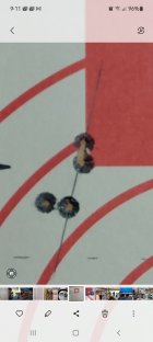

Here’s my four shot target from our February IBS match, my first Dairy Queen and hopefully last, I do use ammo caddy for score but I most likely grabbed one of my score rounds and shot my last sighter with five seconds to go……I think

if that's the case it did cost me the match

Looks like the largest exit meplat hole is the top one - looking from the back of the target. When you look at the exits from the back there is certainly a sideways tear in that center hole. I have seen that multiple times from bullet yaw in multiple holes on the same target.
That electronic gizmo says there are two holes in that one. How it is set up is unknown to me. Is it correct? Again, unknown. Looking at the petals shows nothing conclusive. Man I wish we had a backer for that. This is exactly the kind of issue that happens over and over.
Adding another observation. NONE of the entry patterns have a perfect center hole in the entire petal pattern. All of them show that center hole a bit off center, showing some minor bullet yaw on each entry. In most cases that electronic gizmo has a black pattern sticking out around that circle somewhere. The one with the slightly torn exit back reminds me of torn paper I have seen many times on a single bullet entrance with some yaw.
Also noticing that electronic gizmo is maybe centered on the "X". It is slightly above the "x". That tells me that gizmo is not exactly placed and those results are "relative".
You need a backer. From what I was told the backer fell sideways and missed these impacts. Our review team was NOT contacted on this target to my knowledge. I was the alternate so would not have been contacted anyhow.
It is over but a good reason why you must have a backer. This does happen and happens more often than many think.
