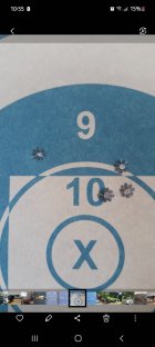

I have been scoring the targets at Deep Creek for a while now. A true double tap is extremely rare. If you study the target close enough you can find that double. I think theres only been one time and I got the refs and even the shooter to try and find it. The target I posted above only took a glance to know there was 5 in that wad. The electronic targets are getting cheap enough now maybe they can be used in conjunction with the paper targets only to verify the number of shot fired and make sure they were during the record period.

Couple years ago we had a "spate" of four-shot targets. We had to DQ near all of them as the evidence in the target itself was more conjecture than evidence. Bullets yaw a bit on target entry and many single shots could be mistaken for multiple shots. I/we have see this often.
Since starting to use the backers in the scoring rings we still hav e had to DQ some shooters. They probably shot 4 shots, simple as that. In many cases we WOULD have done a DQ were it not for evidence shown on the backer.
Now it is possible, very improbable, that a backer could have a hole in it from a previous shooter or target. Then the same backer had the new shot in question actually hit the exact place the backer already had a hole in. That is possible and a good reminder to change the backers as often as is reasonable.
There are no guarantees we make the right decision. Stacking the odds in favor of a right decision is our goal. I really know, after testing started on this a couple years ago and multiple incidents, the backers make a mistake far less probably than just having a plain piece of paper to examine.

I think at some point something will need to be done. Guys work too hard and put too much time and money into this to get shorted. I just noticed this the other day. Shot at the 600yd Nats in 2021. Potential world record, but with no backer or acoustic devices to know there was 6 on this one it was scored as 5. Would have been nice to know if that high shot was a shot by accident during the sighter period or a cross fire.
View attachment 1323311View attachment 1323312View attachment 1323313
I’m going to ask you a hypothetical question being that you feel there was five shots in that cluster and you were in Scoring shed how would you have scored this target.
