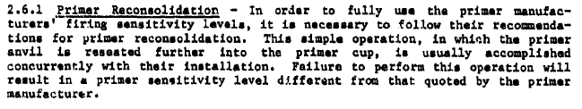

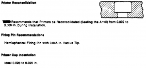

Here is a snippet of public domain specification that I am allowed to share as an example. What they are calling "reconsolidation" is what this forum often calls "crush".
When a device is added to measure the primer output performance, you can observe the consequences of not using the recommendations. The spread of the blast energy will not be as consistent as when installed to specs. The performance is not very sensitive once the anvils are touching, but they are improved by crush within their recommendations. So, don't expect to find a difference on the target for the difference between crush of 0.002" versus 0.006", but with enough of a sample you will find the difference of seated that accidentally leaves the anvil short of the bottom or just barely touching the bottom versus 0.002" - 0.006". YMMV

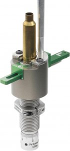

If you've got a good caliper and are somewhat skilled with it, you use the end with the tiny protrusion that comes out at the bottom when you open the caliper to measure depths. It take a little skill to get a consistent measurement.
OR . . . if you want fast and accurate, you can hand over some more $$$ with the Accuracy One tool :D :

did it that way for 50 years this thing came out I have not looked back
