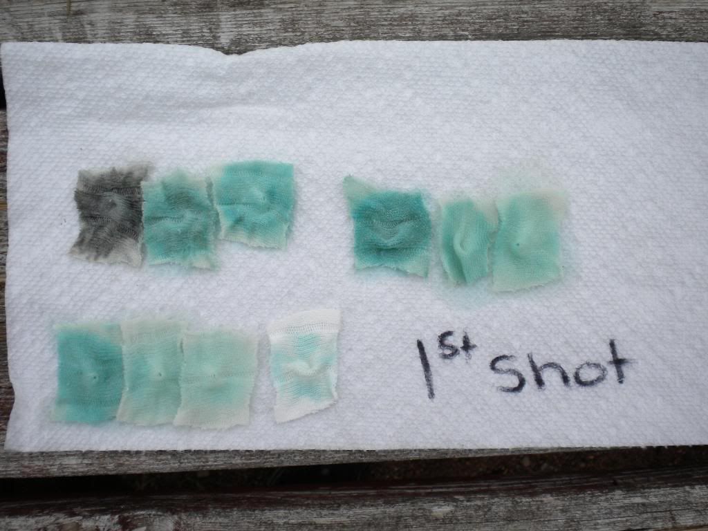

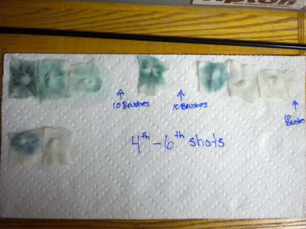

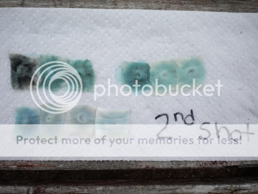

So I finally got to go out to shoot my new Savage Model 12 Benchrest, 6Norma Br. I am still breaking it in. I am shooting once then cleaning and I am using Butches Bore Shine. My patches are turning blue 1st a dark blue then a bright blue. After my 2nd shot and I was cleaning my boyfriend noticed that he could see a large amount of copper just in about 1/4 inch in from the crown. So after that we cleaned it really good with lots of brushing then patching until they didn't really come out blue.
Is it common to have this much copper fouling in the barrel?

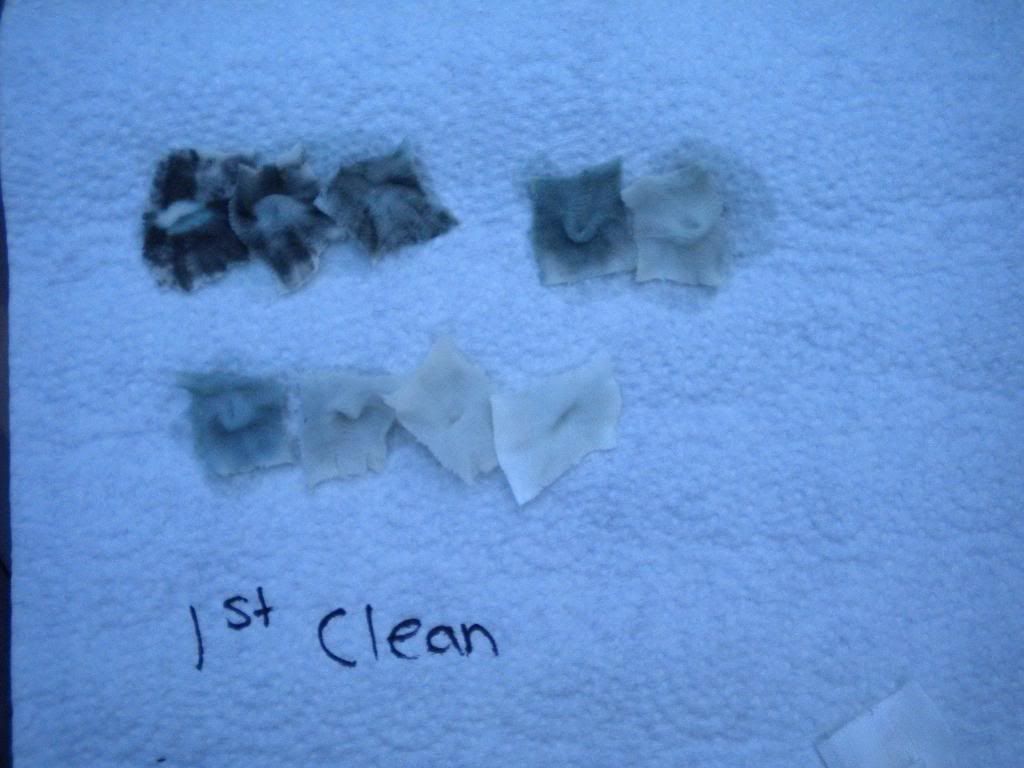

This is the 1st clean before I went out shooting.
The gaps in between the patches means I brushed. When I 1st started I only brushed 3 times then after we noticed the copper fouling we brushed a ton more and for my last cleaning I brushed 10 times. Also shots 4-6 the patch that is alone is one that I ran through then waited about 10 min before I brushed and ran more patches through.

Yes, I did give it a good cleaning before I went out shooting. The 1st pic is the patches from that cleaning. I feel better knowing that this is a normal thing and it should get better in time. :D
Siiri.....now that I read your posting again I see that you stated the first group of patches were a clean prior to shooting the first time. Guess I saw all that carbon and copper fouling and assumed it was your first shot.
So that ties in with my previous posting that the factory put some rounds down the barrel before it left the factory. It would be a safe bet that they did not clean the barrel between shots. Did a test group come with the rifle?

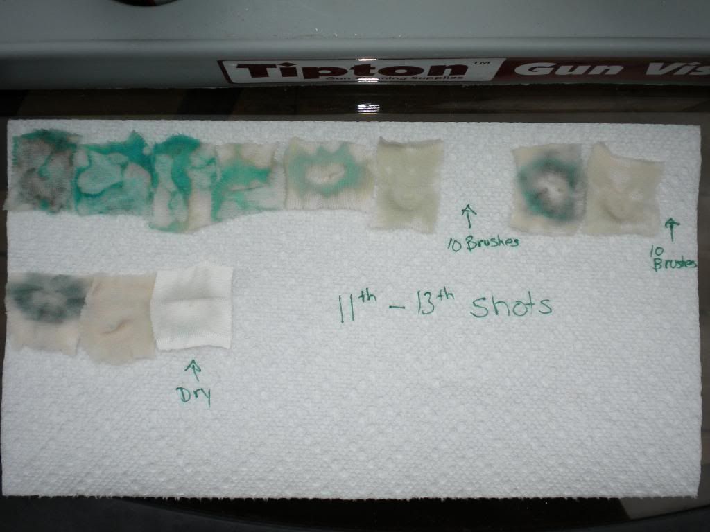

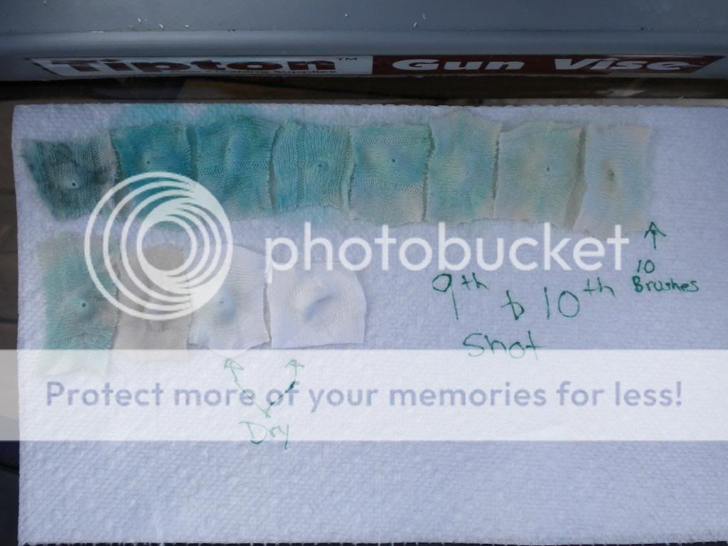

Here is my latest clean... Just 2 shots though it on this cleaning. I used butches bore shine and just patched it out until they turned white then brushed it 10 times then patched it out again until they turned white again.
I have noticed that the copper that I can see at the muzzle is now turning out to be more streaky then just blobs.
