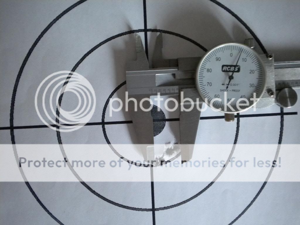

I'm not sure if Siiri is going to post but her gun is shooting great. She shot another sub 1/2" group at 100 yards tonight. That is including the fouler. With out with first shot the second 2 almost went in the same hole. Tomorrow she is going to try one fouler and then a 3 shot group to see what happens.
Also her gun is getting less visual copper at the muzzle with 3 shots now then she was getting with one before.

A .295" group is nothing to sneeze at, I would imagine you could easily be able to do that with five shot groups with just a little work, Congratulations :D

Here are a few more cleanings and groups.
