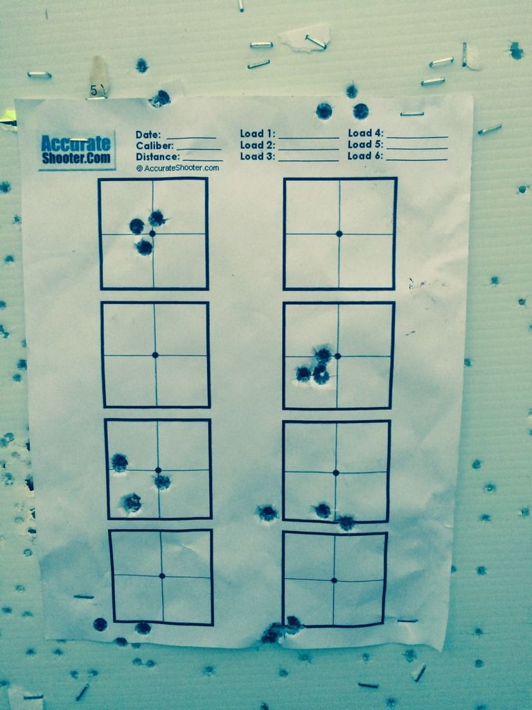

Erik, could I get an opinion?
New test 0.1 grain increments 5 shot groups (Note: first time I've used 5 shot groups ever)
185 Berger Jugg
Lapua PALMA brass
CCI 450 primers
IMR4895
2 sighters in the top left were at 43.5gn
top row: 43.5gn 43.6gn
middle: 43.7gn 43.8gn
bottom: 43.9gn 44.0 gn
Velocities:
43.5: 2646, 2644, 2652, 2678, 2648
43.6: 2675, 2658, 2671, 2666, 2676
43.7: 2674, 2666, 2664, 2675, 2665
43.8: 2672, 2692, 2689, 2679, 2702
43.9: 2685, 2691, 2696, 2689, 2682
44.0: 2684, 2700, 2720, 2712, 2701

43.7 looks good, but looks like you were stringing shots horizontally. How heavy is your trigger?
trigger is at 12oz, first trigger I've had that's under 2#

Work with this load for now. Work on consistency and trigger pull because I think you were the one causing the stringing.
Thanks. I will. I'm pretty sure the stringing is me too.

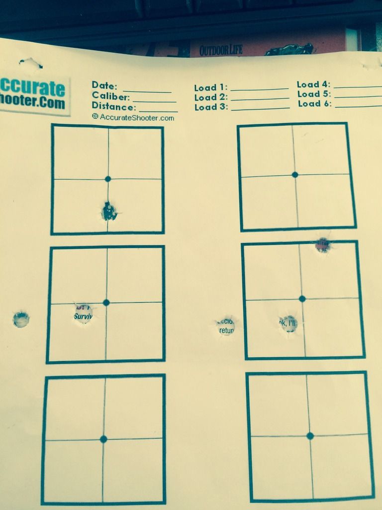

Went back out the other day and worked with 3 shot groups starting at 40.0gr and working to 44.5gr in .5gr increments. I'm not sure if i did this totally correct because my first two groups were high just off of the paper and the third group was high in the top left square while aiming at the square just below so I move the scope down to hit center which makes me wonder if I shouldnt have done that considering we are looking for the groups that line up vertically, but anyway here's my target. I'm pretty new to this as you could tell from my last post but I think I understand it now. top left group is 40.0gr, top right is 40.5. top left square is 41.0gr while aiming at the square below it. 2nd square down on the right is 41.5gr. 3rd on left is 42.0gr. 3rd square on right is 42.5. bottom square on left is 43.0, and bottom square on right is 43.5. On the other target, aiming at the top left square was 44.0gr and aiming at the top right was 44.5gr. i think those groups are big like that due to the barrel being hot?
Hi groundhogassin
Not enough info on your targets I think. Barrel temp can cause poi and group changes, but my advice is to get methodical, record vel for each shot and make notes on each group.
Get set up on bench so that the rifle doesn't move from target when you are not touching it and you will eliminate much of the human error.
The more info we have the better our advice will be.
