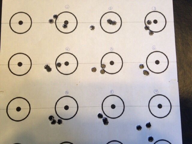

Here's a pic of the raw target:

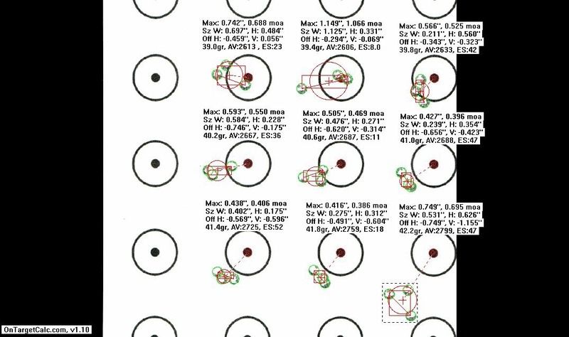

And here it is after being analyzed with the OnTarget Software - vertical distance from POA and chronograph data added:

Harmonics do not only occur in the vertical plane, however, we are only looking for a place where the groups coincide, and vertically is the easiest place to tell since wind would influence horizontal movement of groups.
TikkaSporter said:
- Do we also consider chronograph ES when looking at these?
Yes.
Groups 7 & 8 look good but I will have to ignore ES at this point. You need to do the test again with fireformed brass to see if ES improves.
