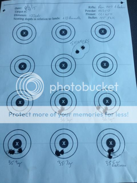

Long range load development at 100 yards.
I was thinking the same Erik but then 36.1 and 36.3 are pretty much identical minus the one wind shot out to the left. Was hoping the 35.8gr area isnt a scatter node that is laying wait to fail when its not wanted. Will do some 10 shot groups at 500m this weekend of 35.8 and 36.2gr to hopefully to see its potential. Its good to see the barrel is fairly tolerant of all that range of charges as they are all pretty close. Looking forward to being able to chrony it soon as well.

This is where I would use ES to decide on which load to tune. 500 yards should help you decide which to tune.

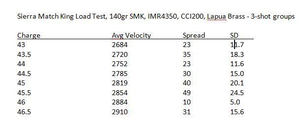

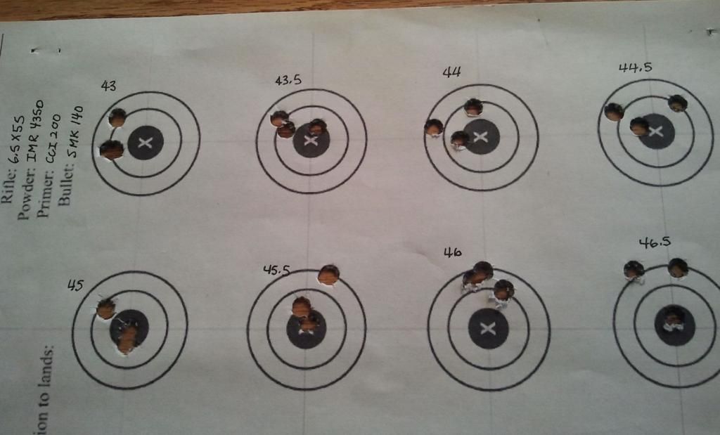

Hi, brand new on the forum with a new 6.5X55 Savage/CBI build I'm working with. Would greatly appreciate any help Erik and others can give me. Shot these groups this morning.
IMR4350, 140gr SMK, CCI 200, in new unfired Lapua cases.
Chrony data is also included. Looks like the node is at 44? Does the chrony spread at 46 point to anything? I believe 46 is getting on the hot side, though brass looked OK and bolt lift was fine. Could tell the increase in recoil though.

Change primers. The ES numbers are too high. I would not go forward with this load combo.

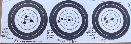

Hi Erik,
I shot this target this morning, looks like the node may be at 39 gr? But I need to change primers also? Would you reshoot the whole test, or just right around 39 gr?
As far as changing primers, different brand, magnum primer, or what? I'm using H-4350 & CCI Lg Rifles.

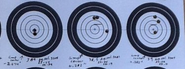

Update: Tried CCI magnum rifle primers with 38.5, 39.0, and 39.5 gr.....SD & ES were virtually identical to the previous data from these charge weights :(. The evidence on the target was much worse than the set of groups using large rifle primers.
Maybe try a different powder? Or a different lot of H-4350?
Thanks Alton9

Ok, I kept looking at the 37.0 gr target, and the low SD & ES. Loaded 36, 36.5, & 37 gr & shot them this morning. The 37 gr load gave low SD & ES again, nearly identical to yesterday's numbers. The group centers were all very near the same. Could 37 be the node? Is it possible that .5 gr increments are too large for this particular combination?
Thanks, alton9

Erik Cortina said:
BY1983 said:
Heres a little harder one to decipher...
I like 35.7 but maybe load a little towards 35.9 since the groups are flat in that direction and vertical the other way. Maybe 35.8 gr.
A follow up on this one. Shot both 35.8gr and 36.2gr for group at club 500 meters F class today on a kongsberg electronic target. The 35.8gr load that looked good but I was suspicious of being a scatter node was indeed that. 1MOA vertical and quite wind sensitive. It scored a 50.1 out of 60.10.
Then shot the 36.2gr load. Much better, X ring vertical (1/2MOA) at 500m and dropped 2 shots from a 10 shot string- one on a dropoff in mirage and one low as I didnt have the group centered properly. Was a tough day for shooting with very few possibles.
Had a crack at 1000ydBR later and shot an 8.5 inch group again in tough conditions. At least it was pretty flat but the little 6 got smashed by the switching mirage. Will probably go back to RL15 for benchrest but the H4350 looks good enough for a club f class load.
