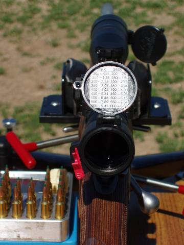

I run what could be called a hybrid version using the VHR.

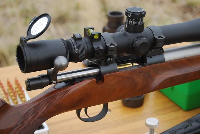

I have the Leupold M1 elevation turret factory installed on all my primary rat rifles that have the VX3 6.5-20X LR scope. I'm a 'dialer', so in the rat patch, it's locate the target and range it, consult the come-up chart in the ocular scope cover, make the needed adjustment in the turret, hold dead-on, allow for wind hold-off and.....shoot.
It works very, very well, but when the shooting is really hot and I'm shooting an area full of targets, no need to dial for each shot, just use the VHR for those shots that require little adjustment. The wind 'ticks' in that reticle are also very nice to have and work well also.
My Sako M75 Varmint 204 with a dual chart for the 32gr and 39gr SBK. All data is in MOA that translates perfectly to the turret hash marks.
Different rifle/caliber, same drill:
Edit: I'll clarify that I make my come-up charts using Sierra Infinity 6 and make each one specific to the actual chrono'd load data, bullet BC and corrected for the usual elevation and environmental conditions I find there at the time of year I shoot there. Not complicated and has been completely spot-on in all the years I've been doing this.
It's been a while since I did this but, the easiest way is to hang a tape measure at 100 yds. I still use strelok and it gives sub tension distances for any power setting for the cartridge chosen.
With your info with a 100 zero, on 20X,
The 1st line is 1.81 MOA down, which is 230 yards
2nd line is 4.13 MOA, which is on at 325 yards
3rd line is 7.02 MOA, which is on at 420 yards
Last half line is 9.35 MOA, which is 480 yards

i just ran the numbers for 200 yd zero 1st line is 272, 2nd line is 350, 3rd line is 430 and the last line is 487. but depends on temp. and altitude and scope height.

I've run the JBM data for my load out to 600 yards and have that. Made sure to put in the measured scope height because that can make a difference. I have a solid 200yd zero for the main cross bar.

Best way to check is to measure off 100 yards, & use a yardstick to measure the lines on 20X, & figure your drops from there.
