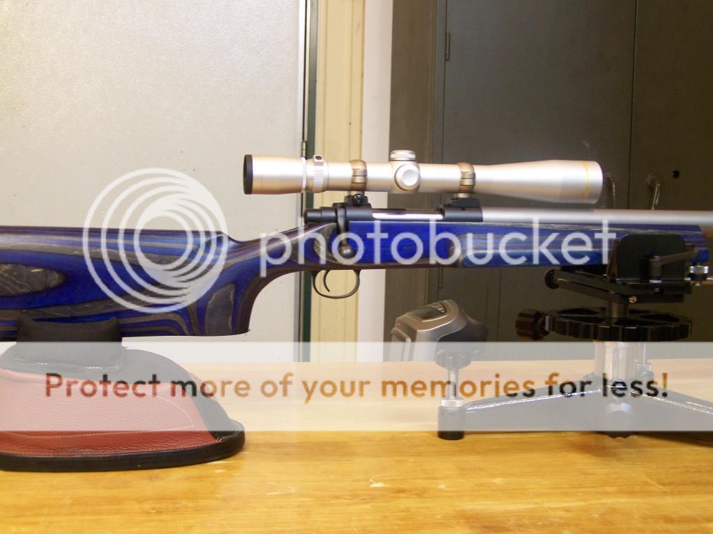

Here's mine, hope to get used to it this year. It's a Cooper 22 Vartac chambered in 22 BR with a 1-12 twist. Optic is VX3 LR 6.5-20x40 VH reticle.

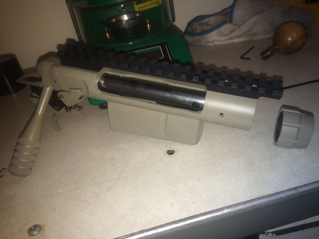

I got mine all put together. I've done some load work up and it seems to being doing decent.
.284 win
162 A-max
Oal 3.175 -.020 jam
53gr. H4350
Vel: 2920

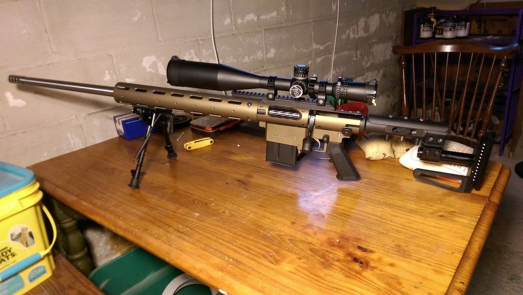

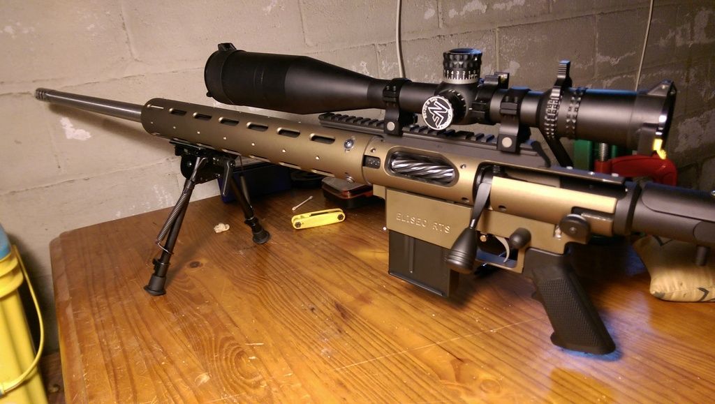

Here is my new 6mm Dasher for 2015:
BAT B action RBLPRE
Krieger 1:8 29" HV barrel
McMillan F-class stock
Jewel Trigger
Nightforce competition scope.
