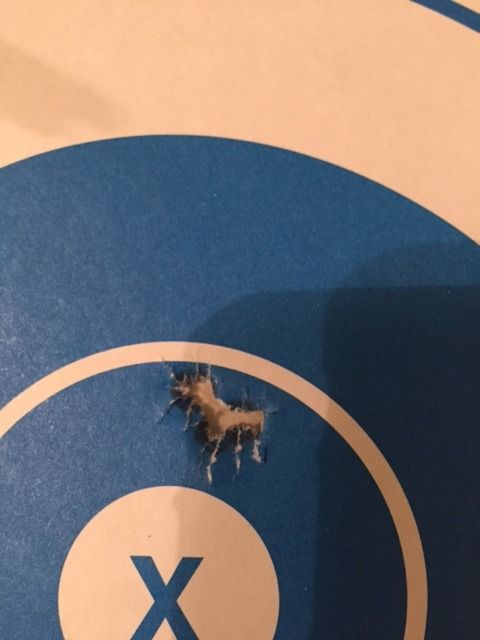

Built this for my daughters Masters in Accounting graduation gift.

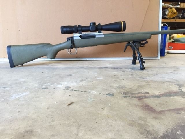

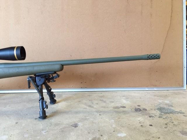

Stiller Predator, 280 AI, Brux, HS Precision, BDL bottom, Shrewd brake, Timney, Leupold VX-6 3x18, Aluma Hyde barrel
Fired two sighters then two three shot groups with 160 accu bonds, was pleased to say the least.

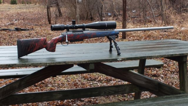

Finished the rifle about 2 months ago and have been forgetting to post it up!
Specs:
6.5x47 Lapua
Remington 700 action
Krieger 28" #17 contour 1:8" twist
Timney Calvin Elite trigger
Bell and Carlson stock
NF SHV 5-20x56 MOAR illuminated with NF base and vortex match precision rings and vortex level bubble
PTG bottom metal and accuratemag 5 round magazine
Have loads worked up for Berger 130 vlds and Hornady 95 gr vmax. Both will shoot sub .25 moa as long as i do my part on the reloading bench and behind the trigger. The 95 vmax is absolutely devastating on coyotes, hides are virtually useless however.

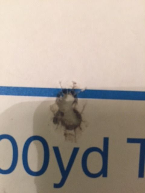

This my 20-250 I built last spring to attempt 1000 yard shooting. Surgeon action 591 R/bottom metal. McMillan A5 adj. PacNor 1.250 x 30 1x9 twist. Jewel HVR. Shoots consistent 0.1's. Muzzle is threaded 1/2x28 for tbac 223P1. ScottIMG_1049.JPG

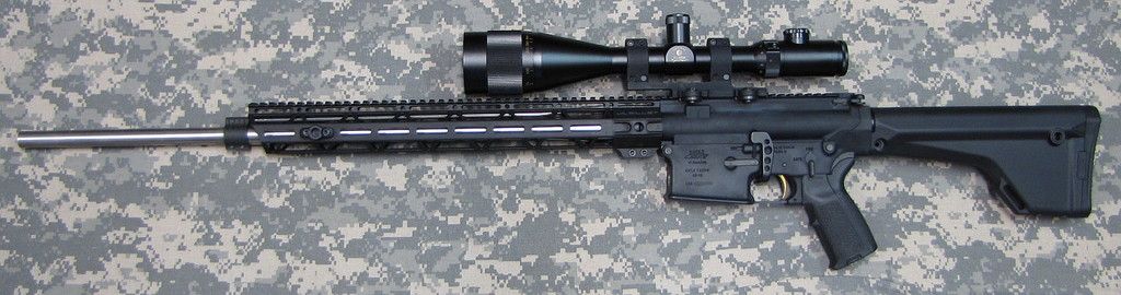

Built a .22-250 upper for my Armalite AR10 last June. Schneider 9 twist finished to 27". 17" gas system, very easy on brass. Only had two weeks to get ready for a prairie dog hunt in July so didn't do much of a load work up, a couple of OCW strings, picked the most promising powder charge and cranked them out. Very happy with the way the gun shot.

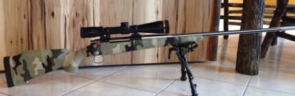

257 weatherby - Mcmillan hunter stock pillar bedded, stainless trued remington 700, cerakoat reciever - polished bolt, Bartlien 2b fluted by Kampfeld, blackened flutes, polished PTG stainless bottom metal, rifle basix trigger. Leupold VX-6 3-18x44. Built by Dave Bruno. 80 TTSX at 3900.
