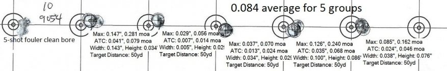

More importantly is when you overlay 4 or 5 - 10 shot groups what then is the total group size. Olympic standard was a 40 shot group < or = to 14mm at 50 meters
This is what I look for in a lot. I don't shoot Olympic style only RFBR ARA to be more correct. only 25 shots but this was not in a tunnel it was shot outside. 0.084 +.223 = 0.307
Five 5-shot groups one after another not an overlay but a true average group add in the rifle was moved to each bull to shoot each group not stationary in a fixture.
Lee
Could you please put a little more flesh on this, ie. is the 14mm ctc or outside. And by Olympic standard do you mean rifles needed to achieve this standard in order to have a chance to win an event. What event? And under what conditions would the test groups have been shot ...indoors?from a bench?in a fixture.
I am not challenging the veracity of your info ... I just really want to understand the context. Thanks.
In ISSF/Olympic circles test groups are normally reported as edge to edge, rather than c-to-c.
There are currently two olympic .22 rifle events: Men's 3Position and Women's 3Position. Both are shot at 50 metres, 10.4mm 10-ring, scored to 0.1 points in finals. The World Championships includes men's and women's 60 shot prone. Men's prone was an Olympic even until after the 2016 Rio games. Up to London 2012 the Olympic ptone record was 600/600 with 51Xs.
AFAIK factory test centres are indoors, and rifles are clamped by the action. Local dealers and clubs may have their own test facilities, which may indoors or outdoors, using all sorts of rigs to hold the rifle.
