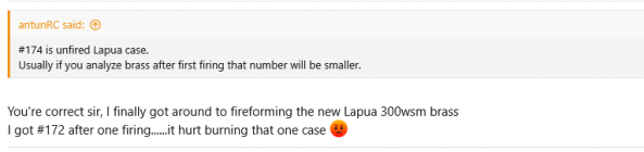

I had some left over ammo loaded 66.4gr H4831SC (fire-forming).
