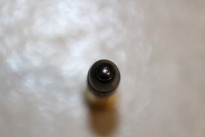

Lapua bullets on CX, M+, and X-Act look like the one below. Don't know if "dimple" is the right word to describe it, but there's a feature on the bullets.
From almost directly above.
or from the punch that seats the bullet?
i don't see that on mine
EDIT: I now see it, but for me to see it, it took a magnifying glass to see it.. i think more now.. that it is from the punch that seats the bullet
No such force is required, the bullet slips in easily and then crimped. It is put there on purpose.
There is no dimple and it's not on purpose. My guess...It's a byproduct of the assembly process.
Left to right on each picture.
Center X, Midas+, Long Range
Reactions: MUP
I think you are correct in that it is something from when they produce the bullet. IMO if it from the seating die or from swagging to form the bullet from the lead wire. in any case it's been there since at least 2013.
