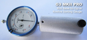

no.. driving band to face of rim
I'm getting ready to start measuring to the first drive band myself, but, in my thinking, the rim thickness is so close, within tenths of a thousandth, (on same box/lot # ammo) that I'm going to try using a regular caliper comparator and measure from base to front drive band, at least initially, to see how it goes.

The lot of Long range I have has over 85% that are within 0.005. with the digital indicator I use that is 0.700-0.705 I would get 3 boxes+ out of 5 with another group 0.690-0.695 for about 50-70rds. less than 30 rds. that were in the 0.710-715 and some 0.680-0.725 (8-10 rds.) this last group is where I saw the high and low shots come from.

"no.. driving band to face of rim"
What do you call the 'face' of the rim, the part of the rim nearest to or farthest from the bullet?
I do not see these even offered anymore. Tried to find instructions - no luck.
the side nearest to the bullet

Interesting concept. Since they are no longer produced, I guess people preferred to spend that $150 on (higher) quality ammo.
I believe Gerry the maker has passed away. I been using one since 2015, I used it mainly at first to check for the OAL of new lots. and see if they were within the OAL that my rifles like. I do use the Nevius chamber which is specific on engraving length. but since current lack of ammo, I been using more and more for actual sorting.
The tool is not a complicated design IMO the cup that rests against the driving band is the key part that needs to be machined with tight tolerances. also, the spring that returns the cup the zero position needs to be light enough, so you won't damage the bullet but still be able to return the cup to the same spot.
