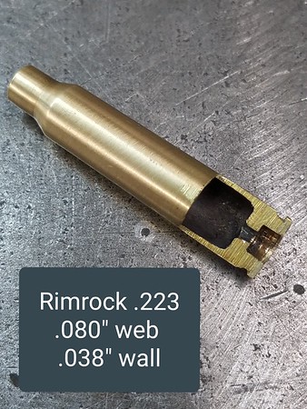

Wait a minute, I'm quoting you, you said that the web at the head was thicker on the LC brass (you even posted a picture). If it's thicker at the web then the volume has to be less than other brass.
I have over 4k pieces of custom head stamped brass from a company in Central Oregon that produced very good shooting 55g Vmax .223. Decided to perform an autopsy on it today and the web looks promising.
I stated the flash hole web was thicker as you can see in the photo of that make case. This adds radial strength to the base of the case and longer primer pocket life. And since the brass is harder the case side wall do not need to be as thick.
Bottom line, just because the flash hole web is thicker doesn't mean the total case weight increases. Simple solution, pick up some different brands of .223/5.56 brass and weigh them yourself.
