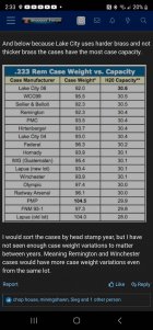

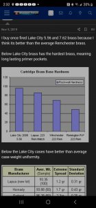

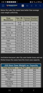

A little info I found on an existing post
