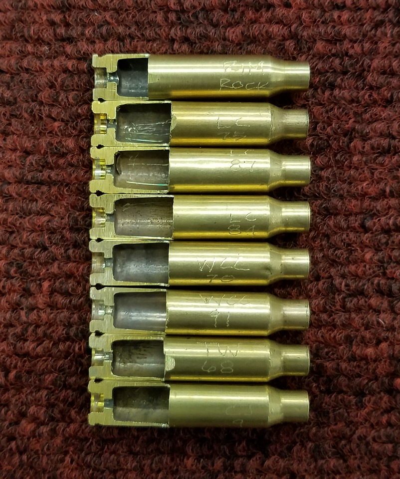

Out of curiosity a couple weeks ago I did some cutaways for comparison.
Measured the web thicknesses at the flash hole.
Top to Bottom:
Rim Rock .0815"
LC 75 .071"
LC 87 .0665"
LC 84 .070"
WCC 70 .061"
WCC 91 .0735"
TW 68 .060"
CJ 9 .070"
I don't know who manufactures the TW & CJ head stamp.
The Rim Rock head stamp is from a small manufacturer in Central Oregon that has disappeared. It was new 55g Vmax I used for sage rat hunting (I have 4k+ pieces). I still have some back stock and tested it in my Tikka Varmint with good results. Not 69g Federal GMM accurate but close, neck and neck with Black Hills Blue 60g Vmax.
I don't have a ball mic to accurately check neck thickness variation though after chamfering necks and measuring with calipers the Rim Rock appears to be more uniform than the others.
Looks like my hoarding may have paid off.... for once. :D
TW was “Twin Cities Army Ammunition Plant”. It was run by Federal ipuntil it closed. It has since been demolished.
CJ is Norinco from China. Some people like it. I use it in specific guns. There are better

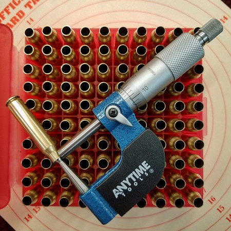

I've been prepping a 100 of the Rim Rock cases for load development, uniforming pockets, chamfering flash holes, FL sizing and bumping shoulder to 1.455-1.4575, trim to length, and now checking neck thickness.
Necks range .010-.012 measuring 6 points around the circumference, extreme has been .010-013, the majority (80%) average .0015" variation.
Weighed 20 cases, low 96.25g and high 97.67g, next lowest 96.39g next highest 97.39g.
How do those numbers sound to you experienced loaders?
Top to Bottom:
Rim Rock .0815"
LC 75 .071"
LC 87 .0665"
LC 84 .070"
WCC 70 .061"
WCC 91 .0735"
TW 68 .060"
CJ 9 .070"
Thanks for digging into this and posting it. It's good to compare my brass's construction, when you did all the legwork!
In doing a little more research on the who supplied Rim Rock with their brass I'm of the belief that they sourced their brass through Nosler since both companies were located in Central Oregon (Bend/Redmond area). In the beginning Rim Rock was using the orange tipped Nosler 55g varmint bullet then switched to the V-Max.
So there is a good chance their private head stamped brass is from Norma. Based on the dimension and weight measurements I've taken it appears to be quite close to Lapua quality brass. Also noted in Nosler's history timeline in 1963 Norma became Nosler’s first commercial loader.
https://www.nosler.com/brass/
If that's the case I'm glad I saved all that brass over the years!
