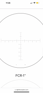

I’ve decided to do a ladder test for load development for my 223. This time around I have a 2ftx2ft target stand. I’m going to put white craft paper over it.
What would be a good mark for an aiming point? It will be shot with the NF FCR-1. I have some 4in round stickers, are these small enough that a slight difference in aiming point won’t skew the data? Any recommendations for a better aiming point?
Edit: forgot to add for my first test I’m going to be at 400yds

I have a bunch of those downloaded. My scope is a NF Competition 15-55. My concern with those targets is not being able to see the center starting at 400 yards

If you are going to use the same point of aim, put the crosshair on it then dial in windage to put your impact point away from your point of aim, so you don't shoot it out...I do this at 100yds,......Have Fun

Target selection is a personal choice. With a cross hair only (No target dot) I would choose a target with horizontal and vertical lines (purchased or drawn) and align my shot on those. I personally find that more consistent than trying to hold steady on/in a dot. The POI would be to the right to avoid hitting my aiming point. My eyes are 72 y/o so that makes a difference.
