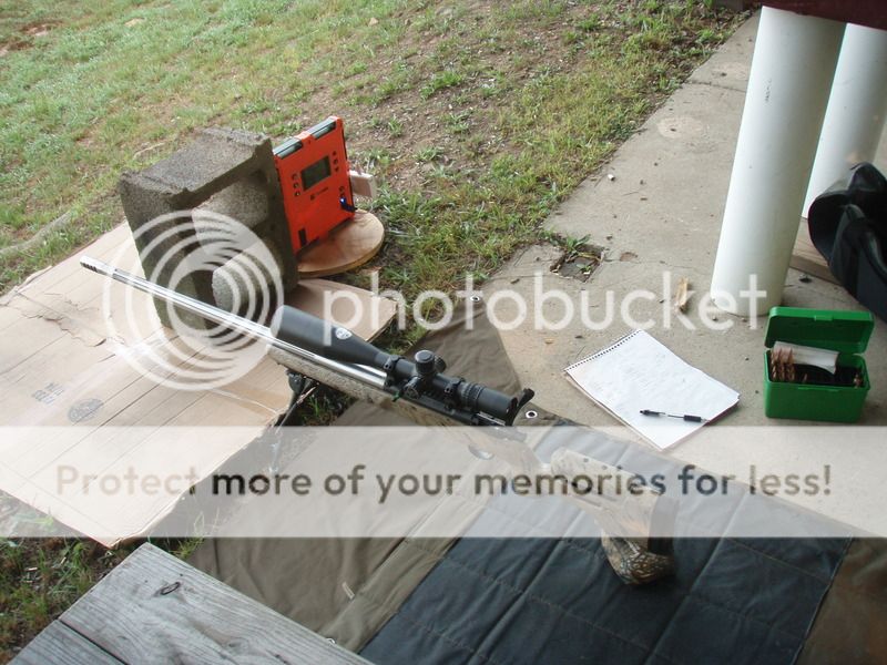

I don't shoot any subsonic or suppressed . I do shoot a few rifles with brakes . I put a cement block between the brake and labradar . for the labradar base I used a scrap piece of 3/4 plywood with a 1/4-20 bolt through the center . this seems to work well for me , I mostly shoot prone .

here is a photo of my home made lab radar base,,,it can be tilted up or down and turned left or right ,,the mark on the center helps align it with the target and the bullet path,,,,plus a convenient place to put the battery pack,,,and note pad and pencil,,
