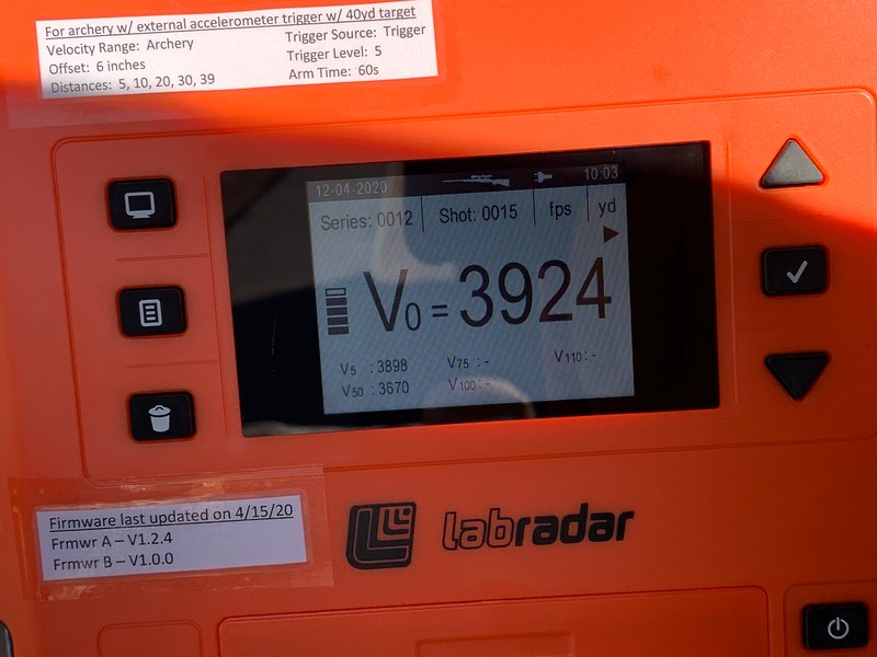

My Labrador tracks .22 cal flat base bullets quite well. The first photo is from Berger 52 gn FB Target bullets in a .22-250. As indicated on the screen, the unit "sees" these .22 bullets past 50 yards, which provides enough data points to calculate an accurate velocity. BTW, 3924 fps is the fastest velocity my Labrador has ever measured, which is why I took the photo.
Haven't tried it with boat tail .22 bullets, which are harder to follow due to their still smaller base.

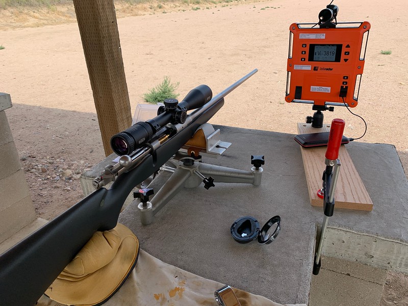

Properly aiming the device does become critical with these small bullets. The old scope mounted on top of the Labradar ensures the main lobe of the radar beam is directed right along the bullet path to maximize the return signal. (I did some testing to determine the direction of the beam relative to the scope's cross hairs, and that configuration is easy to repeat.) With this setup, I can track .30 cal bullets past 100 yards.
