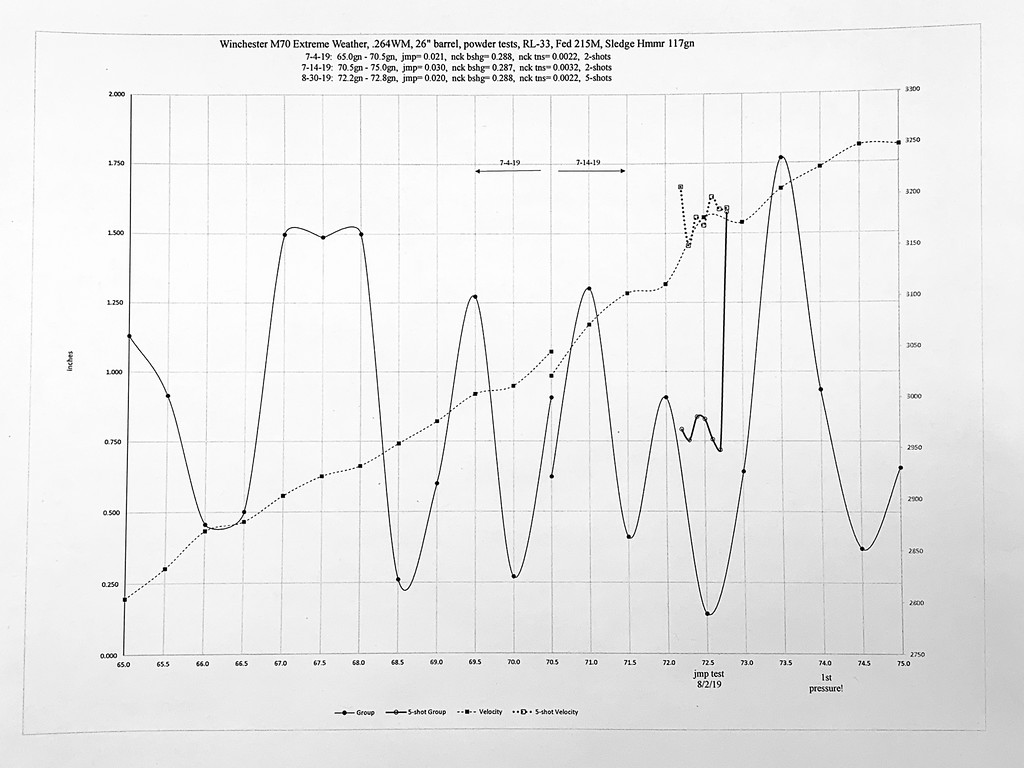

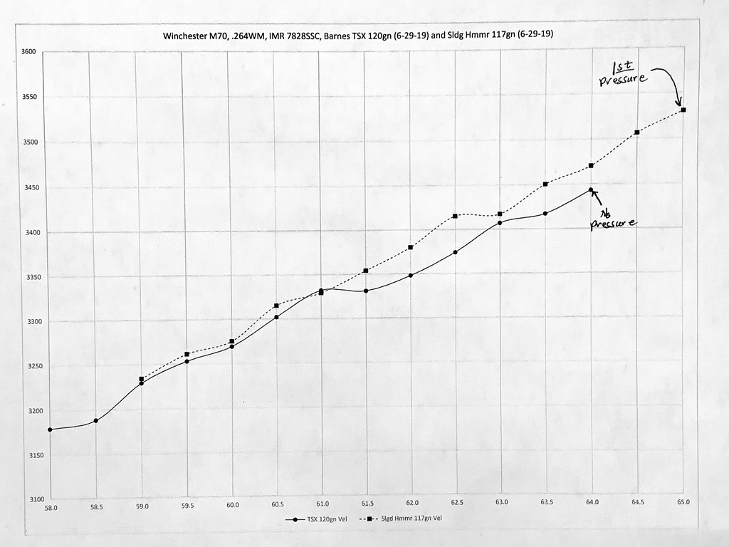

The first photo shows the LR positioned for use with a .223 Rem. The LR would be in the same position for my .264WM, and .300WSM, as well. I wouldn't hesitate to move it closer to the muzzle, though, if I wasn't getting reliable triggers.
If you zoom-in on the second photo, you can see I have set the user-chosen velocity measurements at 10yds (V10), 25yds (V25), 50yds (V50), 75yds (V75), and 100yds (V100). For the shot shown, in addition to the muzzle velocity, the LR screen shows a velocity at 10, 25 and 50 yards, but not at 75 or 100 yards, meaning the unit lost track of the bullet on its own somewhere between 50 and 75 yards. Not bad for a .224 bullet.
