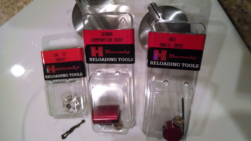

Thanks guys. Here is what I own, aside from calipers. Used to measure off ogive. Is any of this stuff used to measure head space or is it a whole other kit I need? And what exactly is it I am measuring?
Yes you will require the comparator body along with the inserts used for measuring to the datum line... they are essentially the same as the inserts you would use for measuring to ogive on your bullets except that instead of being say .22 or .30 they will be larger so as to come in contact with the shoulder at a specific area.
Here is a picture that shows a few different ways to go about this. The first insert is a Hornady .400" and this would be used where a cartridge would need a .400" insert as per Hornady's recommendation in the sheet that comes with their inserts.
The next insert is one that I have made for a particular cartridge that is actually a spare bullet insert that I reamed out using the chamber reamer.
The third one you see (on the right) is one that is supplied buy the good folks at Whidden gun works , when you purchase their sizing dies they include this so you have a way of measuring to the shoulder datum line.

With your insert of choice installed in the comparator body you then zero your calipers and begin measuring from base to datum, be sure to give the case a slight wiggle and rotate so as to be certain your case is indeed square within the caliper.

Thanks Patch. Just ordered the head space gauge (case gauge) inserts on Amazon and will have them Wed. So if I understand it, I want to avoid excessive head space as it over works the brass. So in AR I want to set die so it will have my sized brass shoulder 0.003-0.004" back from the chamber. Where my head space now is likely much larger than that.
So I measure sized brass and compare it against fired brass. Look at the disparity in the two numbers to see how far back I am bumping shoulder compared to how much it grows when fired. Then set the die up to bump it back 0.003-0.004" from that fire formed measurement. Is that pretty much all that proper head spacing requires?
