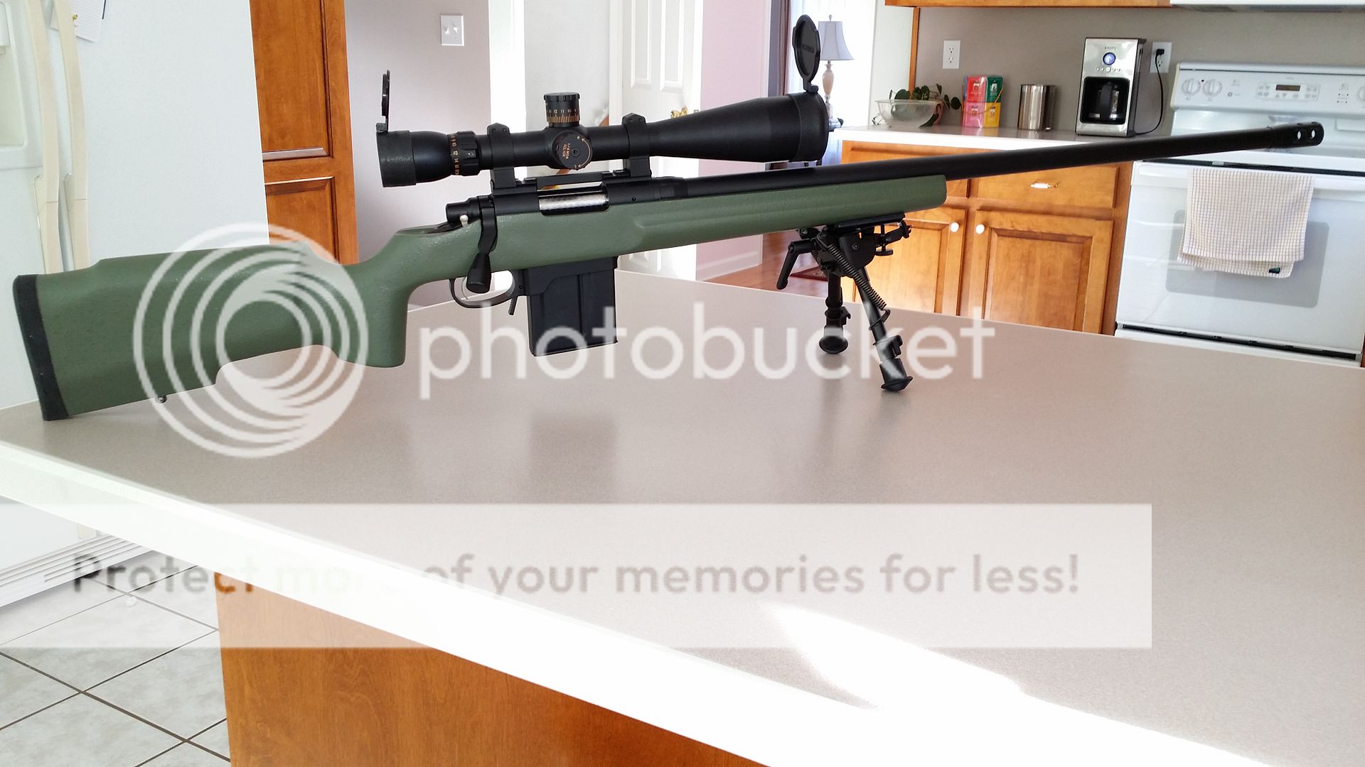

Just finished my first Remage build - 300wsm
sparky123321
I have to thank Jim at Apache Gunworks for the great job he did on my .300wsm Shilen SS Select Match barrel done Remage style.
Remington 700 SA
Shilen SS Select Match .300wsm Remage Barrel
Boyd's Tacticool/Pro Varmint
PTG Bottom Metal
Sightron SIII
You can barely see the nut. Nice job and keep us in the loop as you shoot it in the future.
I'm a big fan of muzzle brakes. I normally go with the JP Recoil Eliminator, but decided to try his standard compensator this time around. I wanted a brake that was going to match the muzzle diameter instead of the tank type on this rifle.
I can't wait to hit the range later this week. I'm hoping the Berger 190's shoot well. It's probably the heaviest bullet I can go with that will fit in the mag and not be seated past the shoulder. Normally I try several bullets and a few different powders when working up a load. I'll try a couple different powders with the 190's and if I don't get <1/2 MOA I'll then try a few different bullets.
Very nice build. The nut looks to be an integral part of the rifle. One of the cleanest I have seen to date. Well done. Looking forward to a range report. 8)

Very nice set up please keep us informed with a range report. I have been wanting to try this Remage set up for a while now I'm starting to feel inspired.
Barrel blank was purchased from MidwayUSA and then chambered and threaded by Jim at Apache Gun Works.

Very nice looking rig. I'm thinking about a Remage over Savage for my next build for extra stock options. Did your stock require any extra inletting to fit the barrel nut?
