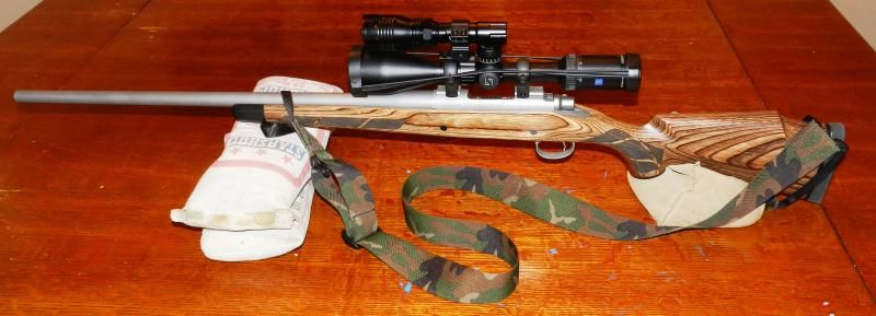

Just picked up my 7mm-08 build from Tumbleweeds Custom Rifles of Round Rock, TX last night. I'm extremely pleased to say the least. Dropped of all the parts on Jan 21 so build only took 62 days total. Mark Pharr did an excellent job.
  • Remington 700 Action
  • 24" 1/9 twist Bartlein #3 Heavy Sporter Contour R5 Barrel
  • Boyd's Laminated Prairie Hunter Stock
  • Kepplinger Single Set Trigger
  • Zeiss HD5 Conquest 5-25x50 w/target turrets
  • VRL-1 Varment Light w/Red & Green modules (Removable)
  • Glass Bedded
  • Free Floated
  • Squared Bolt Face
  • Barrel & Action Beed Blasted to Match
  • Pachmayr Decelerator Pad
  • Boonie Packer Sling
Here are a few pics.
Can't wait to take her out this weekend and see how she shoots.
