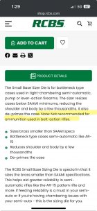

I had problems with some once-fired (supposedly fully reconditioned) LC brass that exhibited the same problem you're having; turned out to be a bulge towards the base. Chambered fine, but would take a lot of force to open the bolt, despite a fairly mild charge. Hitting the brass with a small-base die solved that.

Had the same problem after buying some once-fired LC 308 brass. Problem was just above the web. Small base die took care of it (I think being a little more aggressive on first sizing would have as well, but was trying to minimize working the brass.)
I always anneal and use a SB sizer for LC brass for the first firing. Get a Teslong bore scope so you can inspect your barrel cleaning. Don’t worry about barrel imperfections we using a bore scope, you will go insane worrying over a flaw that has zero effect on accuracy.
