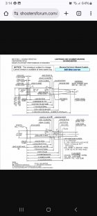

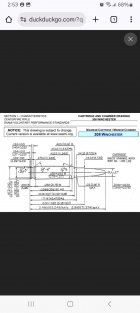

So if you look carefully at the attached image, about midway down on the left side you will see a distance from the case head referenced as .200B. Follow that line up and it shows a dimension (diameter in this case) of .4703.
That is why many of us are confused when you state your fired brass measures .466 and your sized brass measures .460 at the .200 line.
That doesn't seem possible.
I can tell you my sized .308 brass measures .465 and fired brass .467 at the .200 line. Two different chambers.
.460 seems....... unlikely.
Doesn't seem likely that fired brass that measures .466 would be hard to extract, either.
