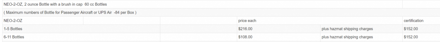

The company write-up says it contains a thermo plastic resin. Also states it contains a binder (the resin)? Look at the price, add HAZMET $. Is this price correct. It's from the NEOLUBE website?
Yes, however... It is less than 0.01% of the content and barely detectable unless you are in the lab.
That halogenated material is a proprietary ingredient that aids with the stacking of the carbon, it is an intentional ingredient but we are talking trace amounts. It makes Neo better than home brews, but it also can disqualify it in other sensitive places where those ingredients were not going to work.
