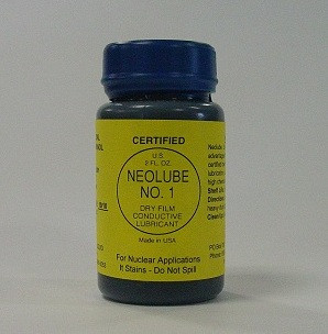

The company write-up says it contains a thermo plastic resin. Also states it contains a binder (the resin)? Look at the price, add HAZMET $. Is this price correct. It's from the NEOLUBE website?
I always get a kick out of the fact that Neo-lube (colloidal graphite in isopropyl) is as expensive as it is. It is the Nuclear Navy’s specified lube for valve caps to help prevent stainless steel gauling. I must have used or wasted a gallon of the stuff in 4 yrs.
once you get it on try to get it off.
But you could probably mix up your own...
add to
and you're there. Bonus: you get to mix up whatever density you want.
I tried to find small amounts of sub-micron graphite; doesn't seem to be available (well, I couldn't find it anyway.) I don't really know if there's a benefit going from 5 micron to sub-micron anyway.
Tip: Add a stainless nut or some other heavy non-reactive item to the bottle to aid in agitating the mix. The graphite tends to settle to the bottom and stay there.
Yes, however... It is less than 0.01% of the content and barely detectable unless you are in the lab.
That halogenated material is a proprietary ingredient that aids with the stacking of the carbon, it is an intentional ingredient but we are talking trace amounts. It makes Neo better than home brews, but it also can disqualify it in other sensitive places where those ingredients were not going to work.
