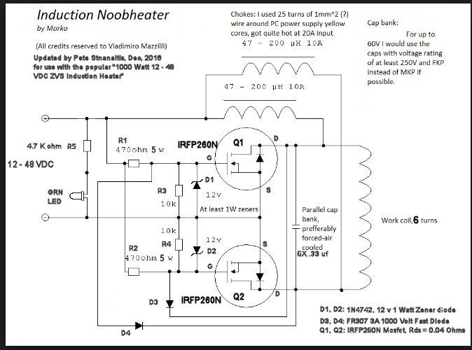

The 'root cause' is a natural product of the circuit.
The only 'issue' with GrocMax's heatsinks is that they aren't where you really want them to be. Nonetheless they likely help a little at the margin. At $10, I decided to add them.
The circuit for these eBay models is very simple. 19 parts - less than my control board. The design is self-oscillating; there's no PLL control of the frequency of oscillation. It's a very basic circuit. Apparently they operate at about 100kHz which is a far higher frequency than commercial units. (I have not verified this.)
And, yes, the board could be laid out in a much better form. Give it a go. The EZ Anneal folks did. PCBs are cheap to produce. Pissing about developing a better version takes time and energy and had best be something you just get a kick out of doing, unless you are going to commercialise it.
"Marko" is this guy:
https://markobakula.wordpress.com/power-electronics/500w-royer-induction-heater/
He took Mazilli's flyback circuit and modified it to work as an induction heater. Note his comments about using the liquid cooling system to also cool the MOSFETs.
