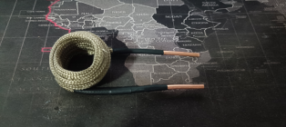

I had similar issues with higher current than I'd like and trying different coils with longer than I'd like times (full 8sec on the MGNZ setup might JUST get my 6.5 brass a dull red in the dark).
I think I finally found the goldilocks coil for my setup.
Sorry to those who might have seen this on another forum. I've been reading everything I can on these machines.
Specs:
3mm copper, insulation pre-installed (yes I have fibres in my fingers, thanks for asking) and wound around a 25mm mandrel (3D printed), so probably ~26mm ID.
2 Layers
Inside Layer - 4 turns
Outside Layer - 3.5 turns
I did make a couple of other changes at the same time. Switched from 12AWG to 10AWG powering the ZVS. I don't think this made any difference because the 10AWG did not get warm at all.
The one thing that may have made a difference is that I had the coil legs going through a metal case (holes drilled big) with a plastic cover (with smaller holes to stop shorting) over it. The metal may have been interfering with the induction. I've since cut a large hole that I will cover with a 3D printed piece.
My quick test showed this one giving a dull glow between 3-4secs with the ZVS unit sitting separately (not in the case of the machine) and no water cooling connected.
