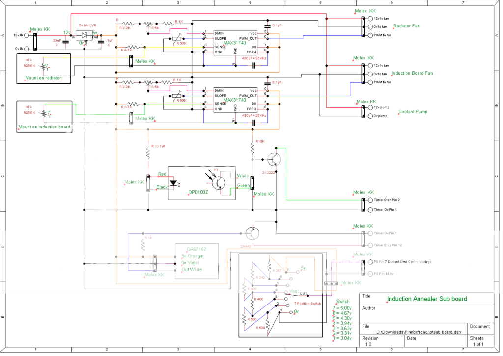

Not sure if this is helpful to anyone or not but here it is-
WOW... From an acorn grows a mighty oak. Nice job.
Added constant current feature, auto feed, higher annealing current, and total case annealed counter. CrocMax, If I left any thing off, please add.
