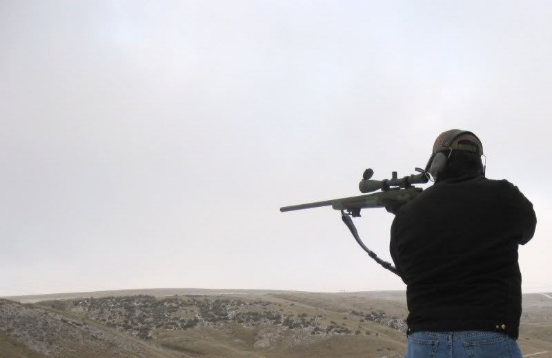

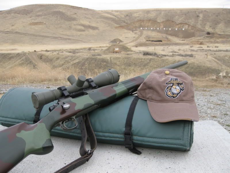

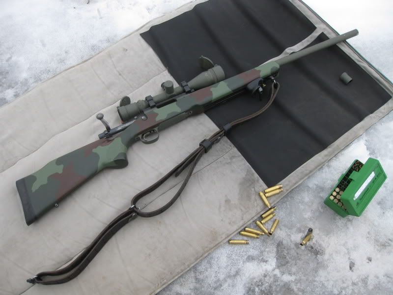

Fits in a backpack:
On the line - yeah, that's snow:
Krieger 1:12 barrel, 24" long, Rem trigger, McMillan stock, 4.5-14x Leupold, Turner sling:
Only took a small buck with it this year, back in the HS Precision stock, a little lighter:
This is the closest thing I've got to a do-it-all rifle, although my old .30-06 comes close... I've thought about setting this Rem up with match sights and a stripper clip too, for NRA highpower matches. Someday.
Regards, Guy
