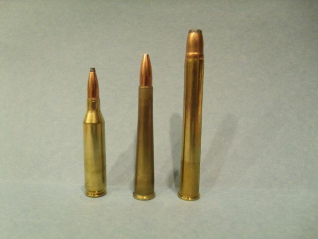

I do keep a Lyman Crusher press also for HEAVY case forming. 20P, 6x45, 22-204, 6mm-204 and 25-204 are easily done by the LEE turret press but 6.5x58R(middle) from 9.3x72R(right) need some serious power.
The bullets for the 6.5x58R need to be swaged from .264 to .260 so those get done on the big Lyman also.
