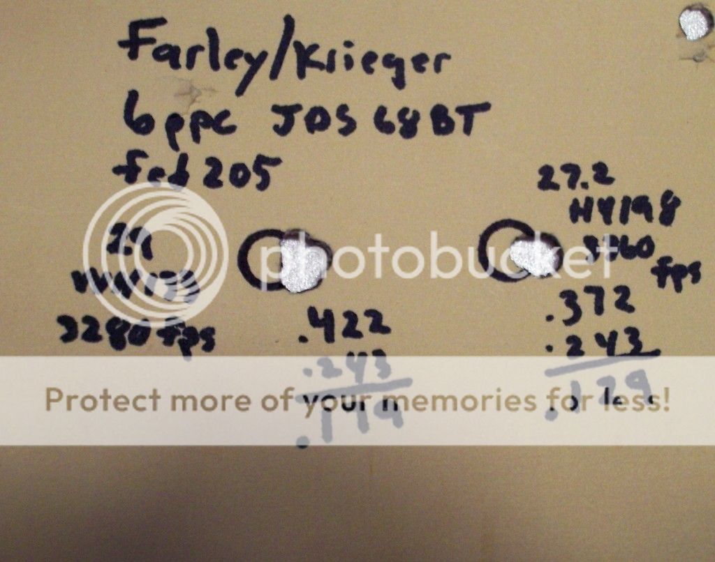

I may shoot H4198 this w/e
seems most people have switched from 133 to LT32 in the 6PPC and a good ole boy is gonna bring me a lb to the match to try before next month but for this w/e it is either 29.0 133 or 27.2 H4198,,I know the crowd may think I am crazy but so far the 4198 load has not thrown a flier or done anything but punch out little groups,,it recoils less and is 80 fps faster,,it may not meter as well but I run all my charges across scales in everything I load,,
shot in very humid conditions this AM with a light breeze,,but over the last couple weeks these two 5 shot groups are about how these loads have been holding in just about all conditions,,

I did shoot 20 shots at one of the 6br.com free targets with the little dots about the time it started raining and left it on the backer,,10 shots with 133 and 10 with 4198,,there was very little difference in the loads but I believe the 4198 may have had 1-2 more complete punch outs of the dot where you couldnt see anything but bullet hole,,combine that with ever time I shoot them side by side the 4198 is .020- .030 smaller 5 shot groups at 100 combined with ever body sayin 133 is hard to keep tuned combined with the extra 80 fps to fight the wind at the 200 stage at the Steamplant cant be a bad thing,,

both these 5 shot groups were shot with the 68 JDS .008 off the lands,,all my seat depth numbers are + or - where the bullet just makes contact with the lands,,I use a rough in type seat depth test procedure and start +.030 and work out .005 at a time shooting 5 shot groups about 2 grs below max powder charge out to -.030 and whichever depth looks best I load .003 both sides of that depth and then load every .001 between the best of those groups,,,then I start up in .5 gr powder charge increments until I think I am high as I need to go and with 3 shot groups and will load 5 rounds of the best looking group and .3 grs each side of it and narrow down my powder charge trying to hit the middle of the fastest node I can,,
I like to use powders that will go over pressure with just enough room in the case to seat the bullet,,with 133 I have to compress load to start getting pressure and not sure I could get enough in to go over pressure,,the next faster powders I had on hand were 4198 and RL7 so I thought the 4198 might make pressure and still have enough room to seat the bullet without compressing powder and maybe get more speed with good accuracy,,so far it looks good to me and I havent tried the RL7 or anything else for that matter,,I have only shot 133 and 4198,,
