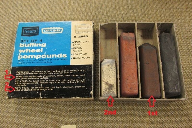

I started with Tripoli, followed with White Rouge. Maybe the White Rouge alone would have worked? (see picture, below)
BTW, I did not use what is gone from those sticks! Those are old, and I have used them for many things. I may have used about 1/8" worth of compound from each stick for the action.
Then, U used a rag with "Mother's Mag & Aluminum Polish", but it was sort of messy, so I switched to "Barrett Jackson Chrome & Metal Polish", and that one worked fine and was easy to use.
Thx!
Alex

I should mention that there were two things I did not polish: the bolt release and the bolt handle. The bolt release is kind of small to hang on to (but do remember to remove it to polish the action), and I did not want to disassemble the bolt to polish the handle. The bolt handle has a sand blast finish, so it would require a bit more work. They look fine as they are anyway.
